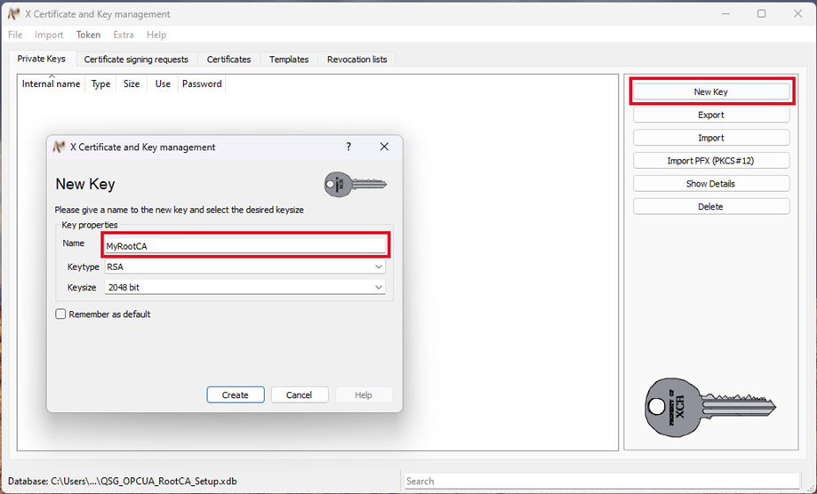

Create a private key
- Go to the tab Private Keys and press New Key
- Provide a name for the key
- Press Create

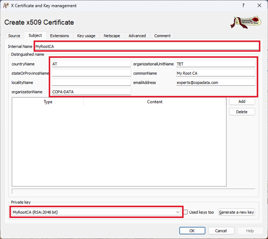

Set the subject of the new certificate
- Go to the tab Subject
- Enter an internal name for the certificate
- Provide information about your organization (not mandatory, but best practice)
- Ensure to select the private key created in the previous steps

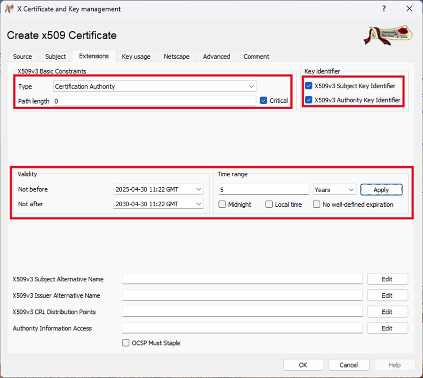

Set the extensions of the new certificate
- Go to the tab Extensions
- Set X509v3 Basic Constraints to:
- Type: Certification Authority
- Path length: 0 (only use a higher number, if sub-CAs shall be allowed)
- Select Critical
- Set Key identifier:
- Select X509v3 Subject Key Identifier
- Select X509v3 Authority Key Identifier
- Set validity as required

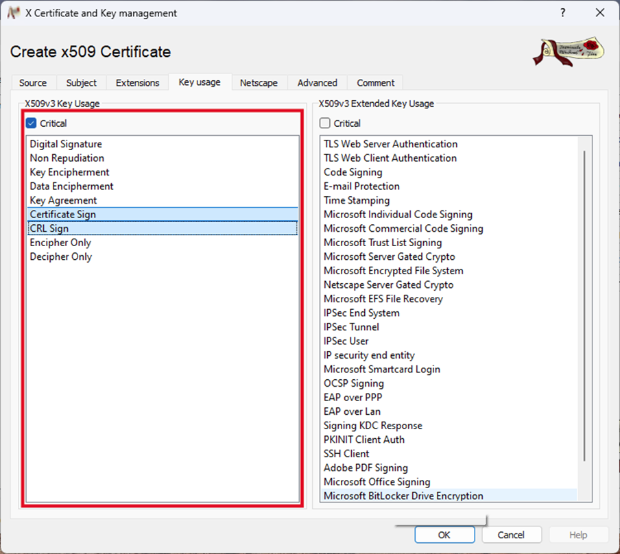

Set the key usage of the new certificate
- Go to the tab Key usage
- Set X509v3 Key Usage:
- Select Critical
- Select Certificate Sign, CRL Sign
- Press OK

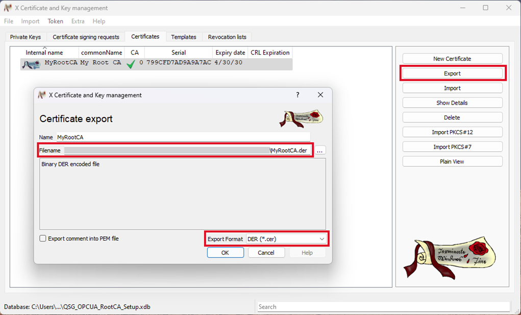

Export the certificate
- Select the newly generated certificate and press Export
- Provide a file name for the certificate and ensure to set the file extension to .der
- Ensure that the export format is set to DER
- Press OK

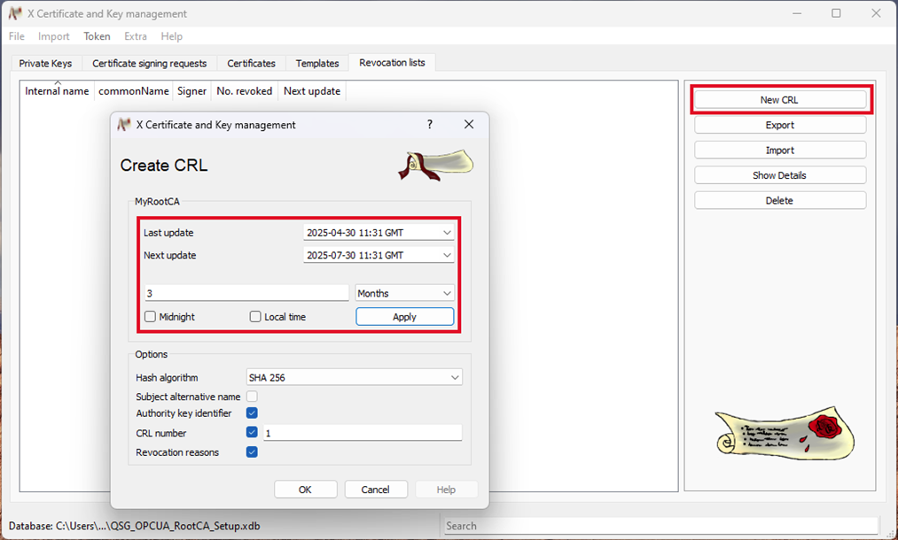

Create a new revocation list (CRL)
- Go to the tab Revocation lists and press New CRL
- Setup the parameters as required
- Press OK
The CRL becomes invalid after the defined period has elapsed. Then, a new CRL must be created and distributed to all hosts!

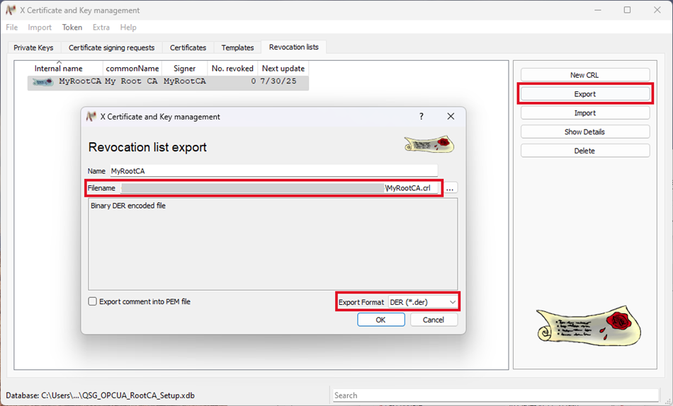

Export the revocation list
- Select the newly generated revocation list and press Export
- Provide a file name for the revocation list and ensure to set the file extension to .crl
- Press OK
