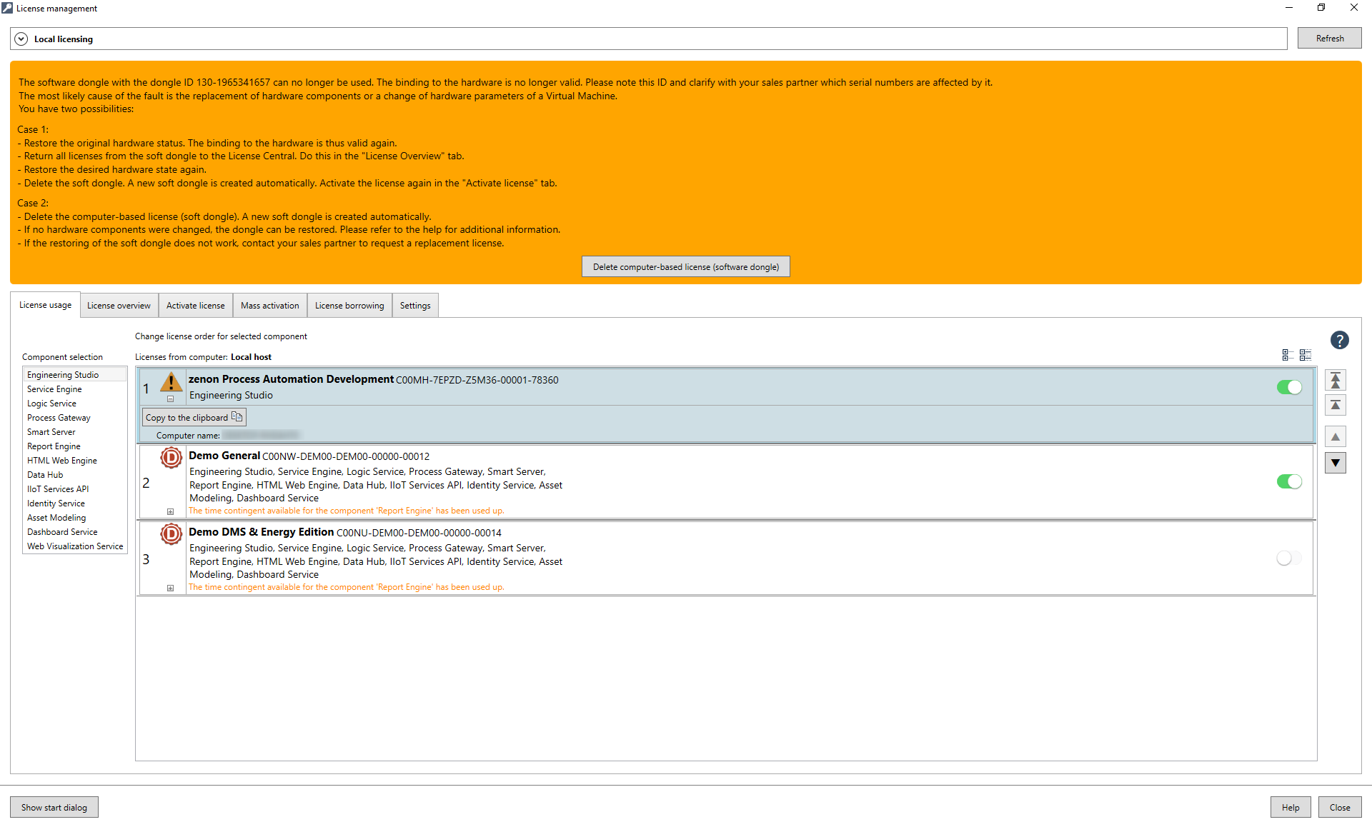

Yellow Box appears in the License Manager
FAQ: Yellow Box appears in the License Manager
Under the following circumstances a yellow box can appear.
