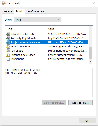

The creation of the DNS name in the OPC-UA Server certificate may vary depending on the zenon build and if the machine is within a Workgroup or is part of a Domain.
This information can be verified in the certificate, the certificates files (*.der) created by zenon can be found in:
C:\ProgramData\COPA-DATA\System\PKI\CA\certs

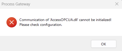

In the case that there is a mismatch between the DNS Name in the certificate and the Name of the machine, causing the startup failure of the OPC-UA Server.
Eg: Workgroup machine or a machine using a suffix and a newer zenon build. do the steps bellow:
  1. Open the directory  C:\Windows\System32\drivers\etc\;
  2. Open the file hosts and add an entry with the localhost IP and the same name as it is issued in the certificate.
