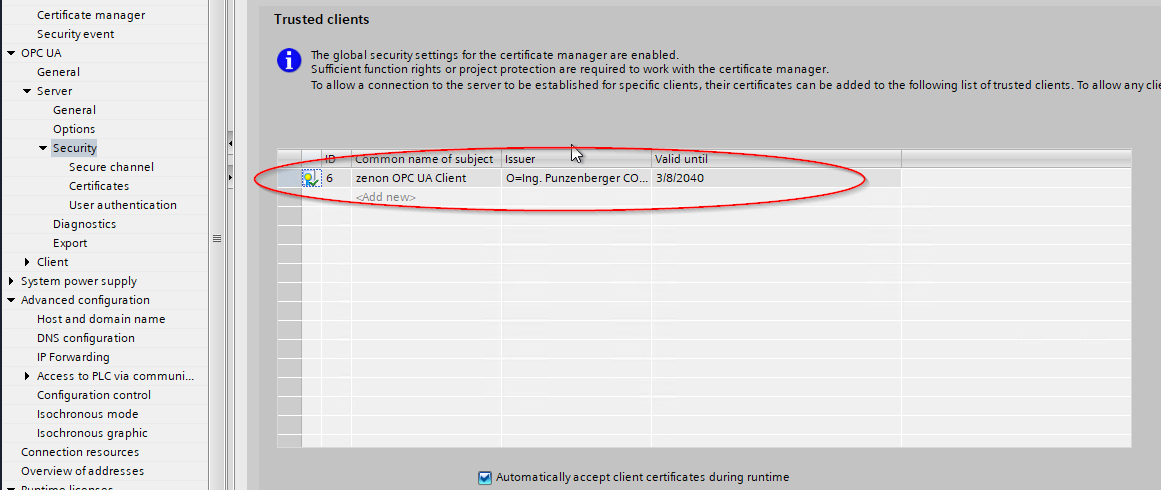

Copy the OPC UA Certifcate “OPCUA32.der” to the OPC UA Server and import the Certificate via TIA portal
add the OPC UA client to the trusted clients in TIA portal
