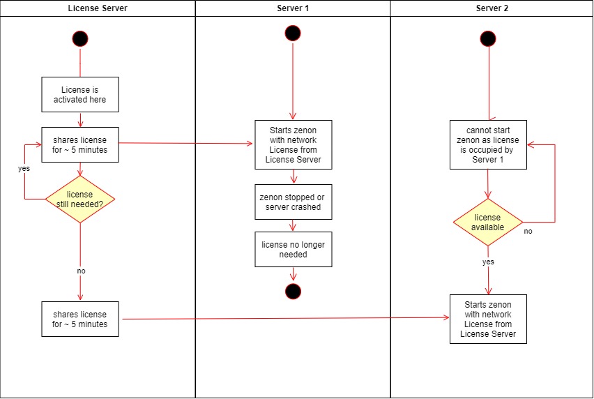

Starting from zenon version 8.00 it is possible to share each license over the CodeMeter network. This allows you to have a dedicated license server. The license server can be any PC or virtual machine which runs CodeMeter.
One license for two
Sharing a license in the network implies that the very same license can be used on different systems - but just only once.
This setting can be used if you have a backup system or use a shared engineering license. The one who needs the license (first) takes it and excludes the other from operating zenon. Note that both systems cannot run simultanously.

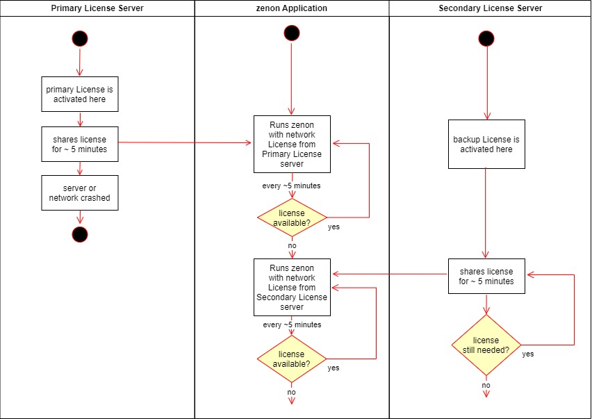

Two licenses for one
As the license server could also fail and therefore zenon would not be able to operate on either Server 1 or Server 2, it is also possible to have a backup license (for each zenon application). In that case you need two licenses which are equal (at the best). If the licenses are not equal, make sure, that the backup license is the better one. The zenon license redundancy picks only equal or better licenses.
The primary or secondary license server can also be the system which runs the zenon application.
It is possible to have up to 10 backup licenses configured.
For the configuration the zenon License Manager can be used. The entries are stored in the License.ini of each zenon system.
The demo license can be used as backup license of the last resort.
