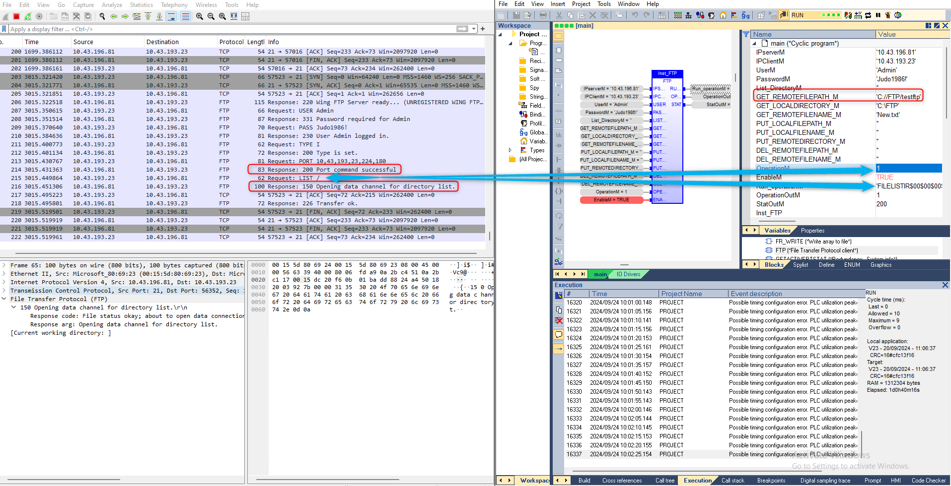

- Configure the function block with the following information (Screenshot) . Remember to use the FTP format (with double slashes, //) for Get_Remotefilepath.
- After executing Operation 1 -> List, the serverfilelist.txt file will be created in the C:\Windows\Temp directory. Please note that you must navigate directly to this path, rather than using the %temp% variable, to locate the file.
