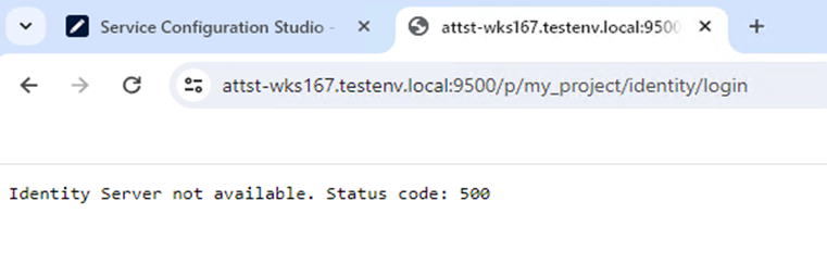

If you encounter following Error description: Error: Identity Server not available. Status code: 500

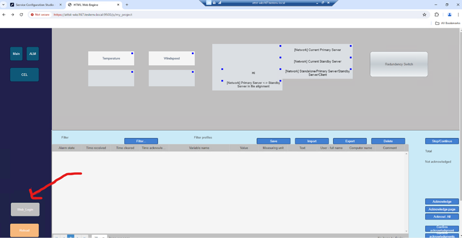

The above error occurs when a link is clicked in the web engine behind which there is a ScreenSwitchFunct to a login screen.

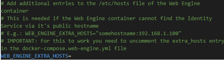

With setting the DNS manually in the Windows Docker Desktop Engine, this will also allow correct name resolution with the host machine.
With this approach, it is even not necessary anymore to add the "extra_hosts" entry for the Web Engine.

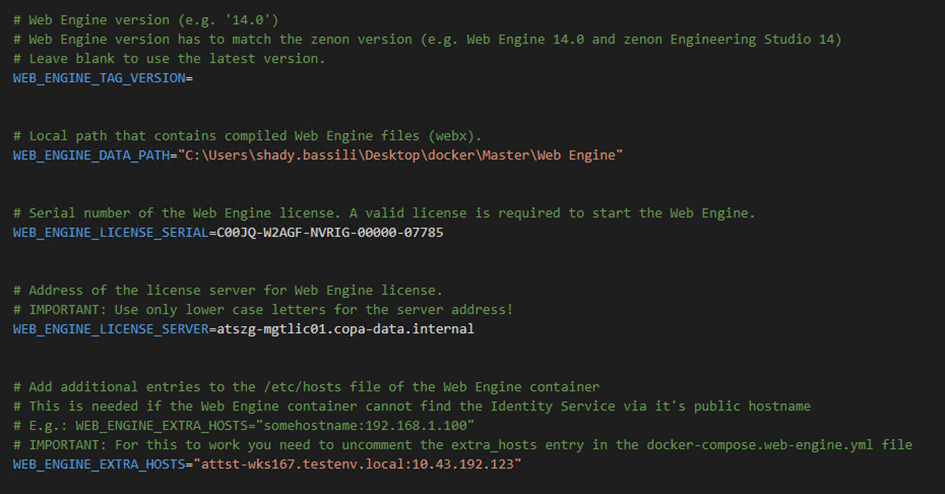

.env file now updated to include:
When configured the Web Engine is able to be successfully connected.
