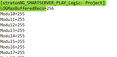

  1. Alternative method using zenon Configuration file
Alternatively, it is possible to amend the logging level of COPA-DATA processes directly in zenon6.ini file (zenon Configuration file) of the target computer (path: %CD_SYSTEM%). In this case, navigate in this file to the respective logging section of the process(es) you wish to modify the logging level (revert to default). The respective logging section of a process can be easily identified by the [process name + _project name_driver identification (if applicable, e.g. zenon driver)] and when the next line includes the parameter LOGMaxBufferedRecs=...
As soon you identify the respective section, you can delete it completely until the next section is started. You can repeat the same proceedure to all COPA-DATA processes that you wish to revert to default logging settings. Doing this changes in zenon6.ini allows to apply the changes to multiple processes faster.
To revert the zenLogSrv logging parameters to default via zenon6.ini, you can look for the respective section in zenon6.ini file too: [LOGGING_SYSTEM]. Deleting this section completely will revert the zenLogSrv settings to default.
