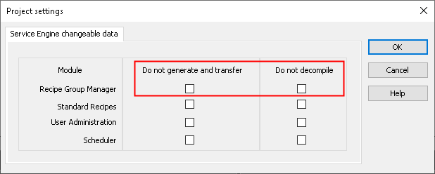

  3. Ensure that the decompile flag is disabled in the project settings.
  4. XML export all recipe groups and XML import them after. This will correct the structuring of the recipes and you can continue using those.
  5. Create and transfer the Service Engine files.
  6. Ensure that the “don’t create runtime files” flag is disabled in the project settings (as picture above).
