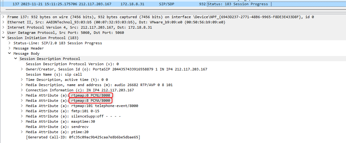

It is possible to find which codec is being used via a wireshark capture, in the the packets from the SIP/SDP Protocol, eg:
