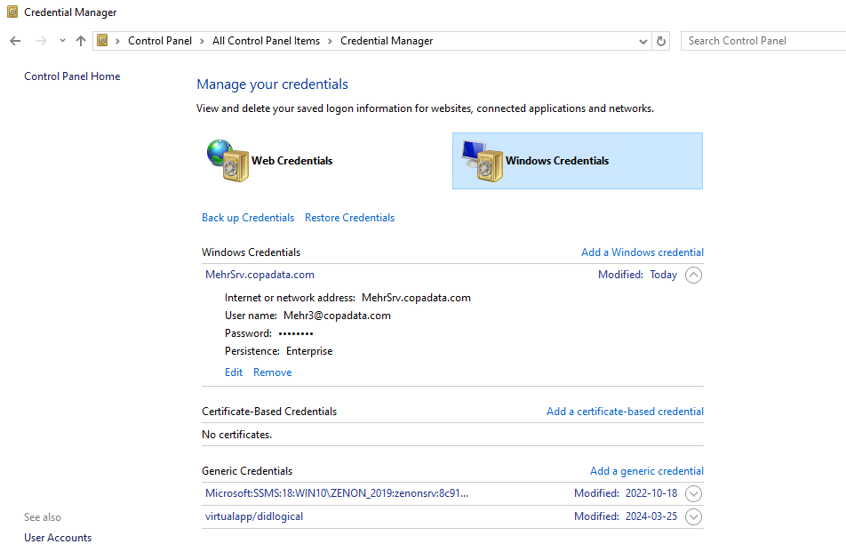

- Go to Credential Manager on the client site where the local user is logged in.
- Under Network, enter the Server FQDN (Fully Qualified Domain Name).
- In Username, enter the AD username.
- Finally, enter the password of the account in the Password field
