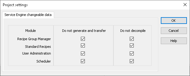

How to change the settings: Dialog Service Engine changeable files
You can reach the dialog for configuring the Service Engine changeable files via project settings General/Service Engine changeable data:
The following file types can be selected:
