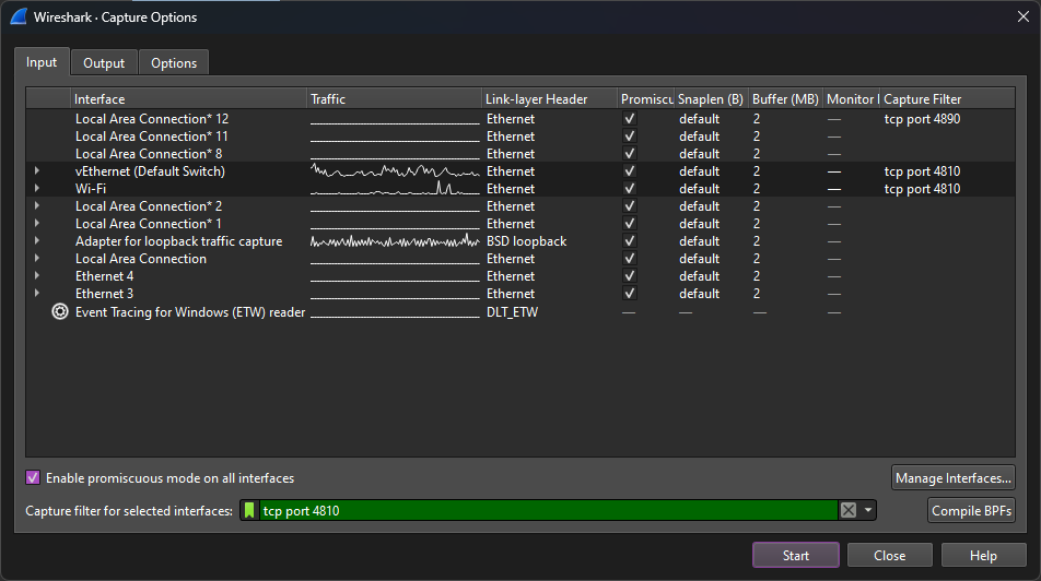

- Start Wireshark and open Options dialog.
- In Input tab, select the network adapter used to communicate with the target OPC UA Client.
- In Input tab, add the capture filter: 'tcp port 4810'. ( = Listening TCP port of the OPC UA Server running in the local machine).

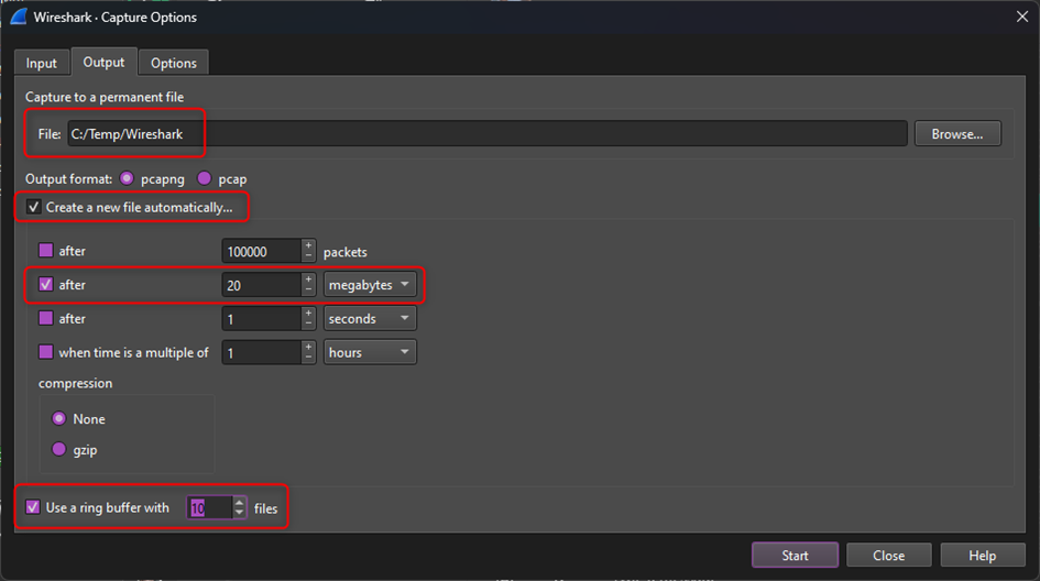

- In Output tab enter the following configuration (or similar):

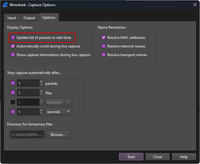

- In Options tab, make sure "Update list of packets in real-time" is disabled. Note: This is very important to prevent memory and CPU continuous increase when collecting the protocol sniff.
