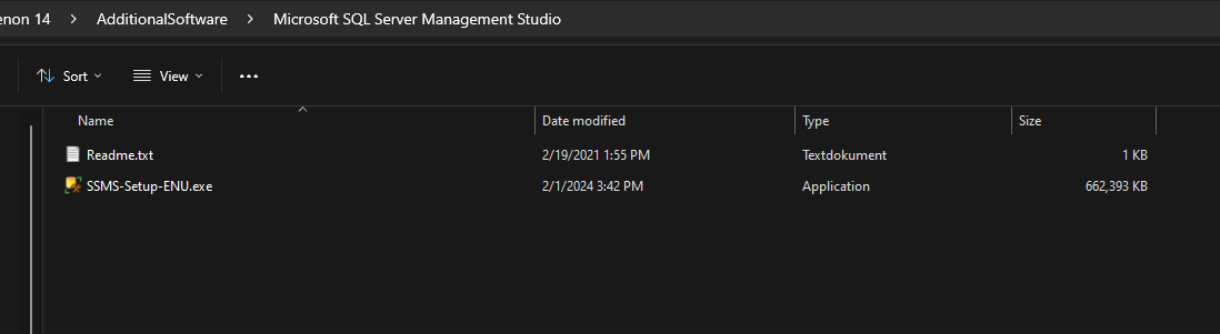

To check either, install Microsoft SQL Server Management Studio (SSMS). The setup can be found within the zenon .ISO under /AdditionalSoftware/Microsoft SQL Server Management Studio
Run the setup. Once it's complete, start SSMS.

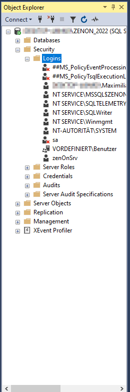

Once you're logged in, navigate to the Object Explorer on the left side of your screen.
The Object Explorer displays directories, database instances and users stored on the database server.

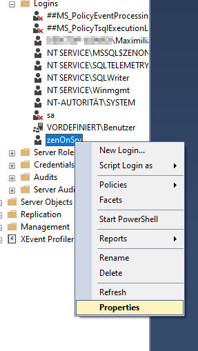

Navigate to the following directory Security > Logins:
A list of every user instance stored will be displayed. Look for the zenon default user "zenOnSrv".

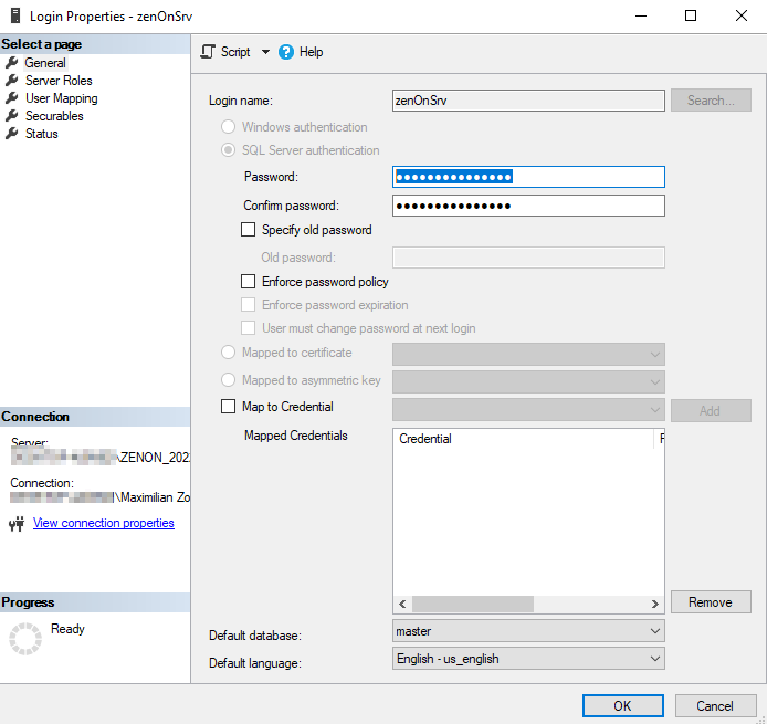

If there is an instance to be found, either double-click on the instance or right-click on the user and select Properties to edit it.
Enter a new password and click OK to apply the changes made to the user.

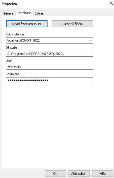

Open the zenon Startup Tool. Select Profile > Edit Profile... to make changes to your zenon profile.
Please make sure to register the zenon version where this scenario occurs first. If you have multiple versions of zenon installed and do not register the correct version beforehand, you may edit the credentials for a different database server and lock yourself out!
Select the Tab Database. Enter the new password you had previously given to the SQL server. Click OK to apply changes.

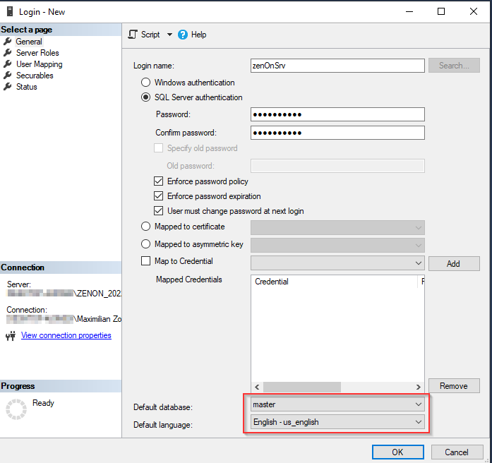

Right-click to bring up the context menu and select "New Login...".
Enter a new username and password. In our case, we will name the instance "zenOnSrv". You can also give the user a different name, but make sure that the credentials match.
Also, make sure that "master" is set as the default database and English as the default language.

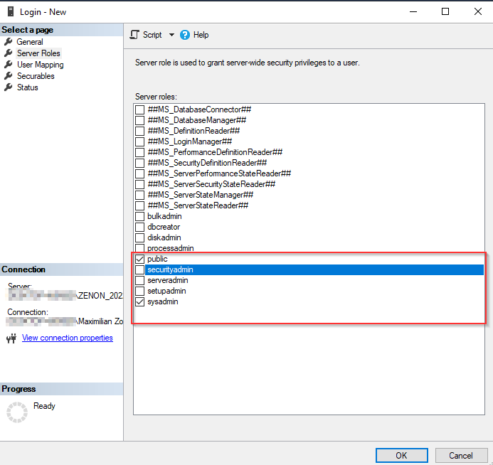

Move one page down to Server Roles.
Select the following roles:

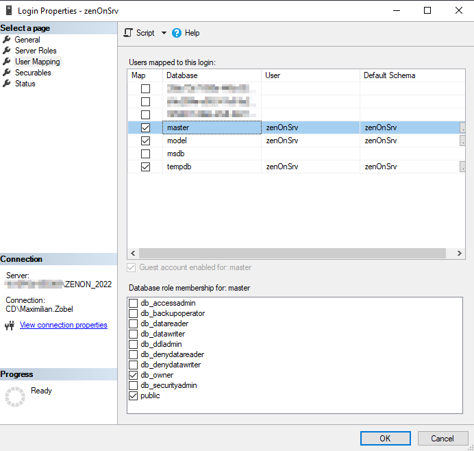

Next, we move onto User Mapping.
Here you'll find databases you can map your user to.
Your user must be mapped to "master""model" and "tempdb".
For each database, the following role memberships must be selected "db_owner" and "public".

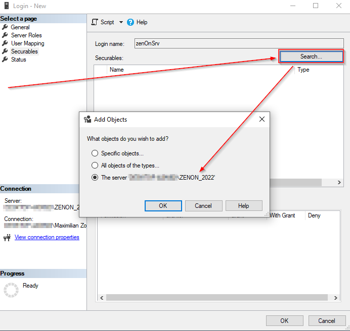

Heading one page further down to the Securables, your database server must be available as an object instance.
Add an instance by clicking on Search...
A dialog window will come up, asking you to select an object. Select your database server and click OK.

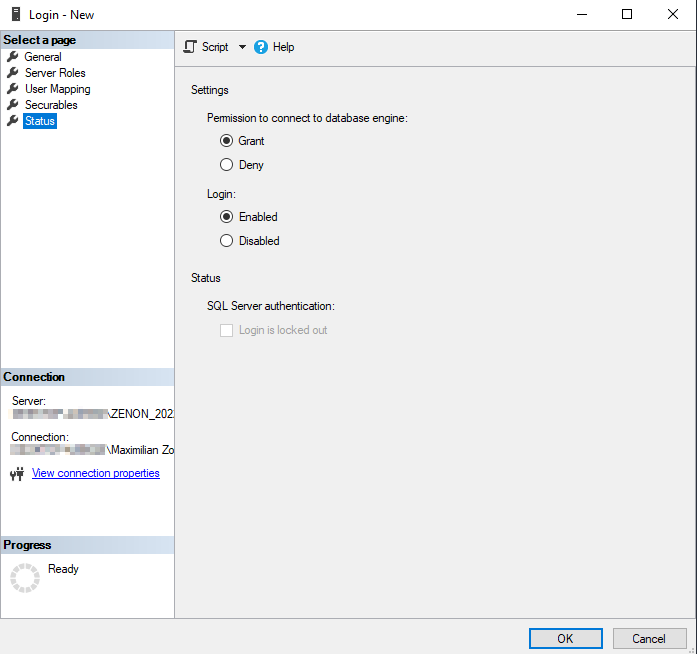

On the final page, select both Grant and Enabled to allow your user to connect and login into the Database.
With our user now being created and all set up, head into the Startup Tool, referring back to the first possible cause, and select Profile > Edit Profile... to make changes to your zenon profile.
Preview
Select the tab Database and enter your new user credentials.
