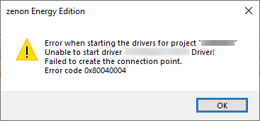

  1. Screenshot and followed instructions of error/warning messages shown.
  2. Driver configuration dialog does not open in Engineering Studio (error 0x80040004).
    1. zenDrvOpsManager.exe is not listed in Windows Task Manager details window (process list).
    2. Close Engineering Studio and re-register zenon from the Startup Tool. -> zenDrvOpsManager.exe is now started.
  3. Service Engine cannot establish communication with zenDrvOpsManager and it throws the error 0x80040004. Respective driver does not start.
