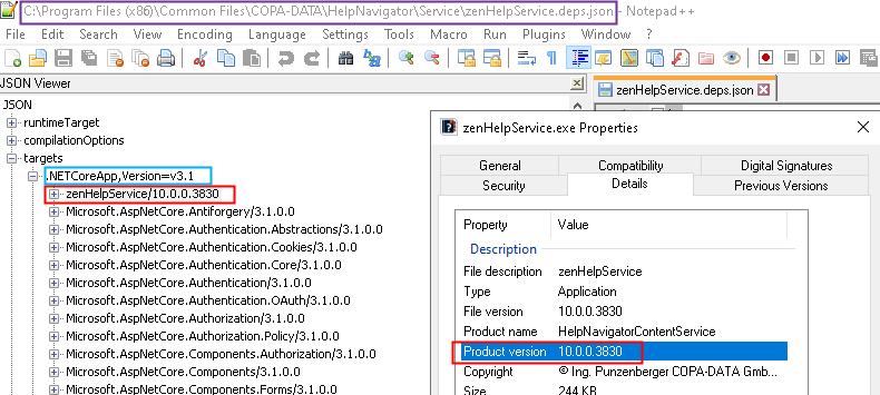

  3. Mismatch between the zenHelpService.deps.json file and zenHelpService.exe version (see red boxes in screenshot below). These files are located in the "%programfiles(x86)%\Common Files\COPA-DATA\HelpNavigator\Service" folder.
  4. -> Perform a build update of the zenon software component with the highest version installed.

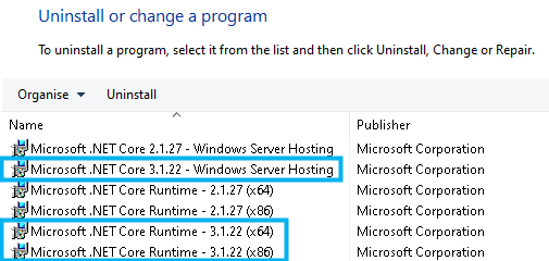

  5. Wrong/Missing Microsoft .NET Core version installed (see blue box in screenshot above). The latest version can be downloaded from here .
  6. Info
    The respective installation folders are:
    64-bit: %programfiles%\dotnet\host\fxr\3.1.xx
    32-bit: %programfiles(x86)%\dotnet\host\fxr\3.1.xx
