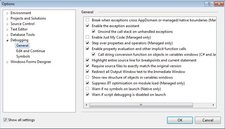

- Check the Debug settings in the VSTA IDE->"Tools"->"Options..". Compare the setting with the image:

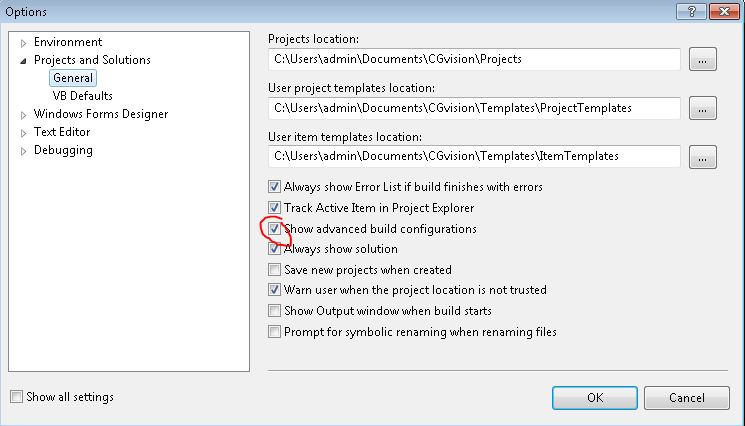

- Check the setting of the Release/Debug. Set the setting for the advanced build configuration "Show advanced build configurations".

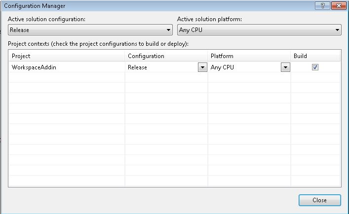

- Restart the VSTA IDE and open the Menu "Build"->"Configuration Manager..". Set settings to Release.

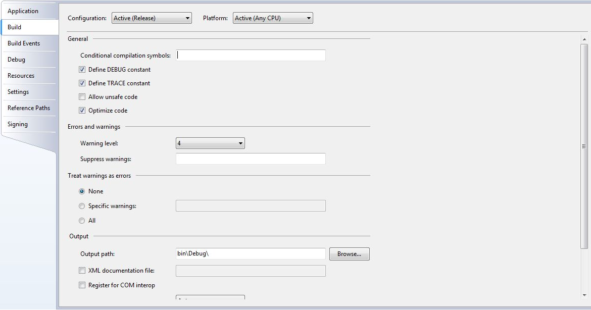

- Next set the Project settings. Select the Project in the "Project Explorer" and open the context menu. Click on the "Properties". Check the settings and compare with the image.
