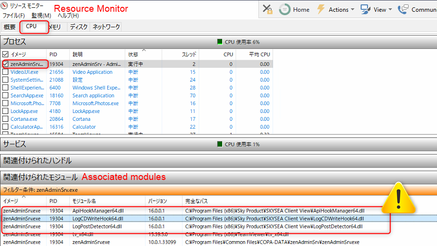

        4. Make sure that cyber-security software (e.g. Antivirus, Windows Defender, etc.) allows installation and does not report any installation blockage.
          1. Installation also fails when separating the computer from network and cyber-security software has been disabled.
          2. Most commonly, cyber-security software prevents zenon Software Platform services (e.g. zenLogSrv, zenAdminSrv, etc..) from starting or execute properly.
          3. Using Windows Resource Monitor filtered to zenon processes/services allows to see 3rd party DLLs attached to the respective executable.
