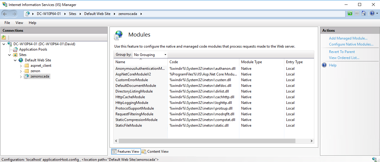

- The number of client connections by Microsoft IIS has not been reached in Windows desktop operating systems - this number depends on the version installed. For Windows Server operating systems no limitation applies.
- Required modules have been installed.
- zenon Smart Server (includes Microsoft Web Deploy installation).
- IIS Publishing Service.

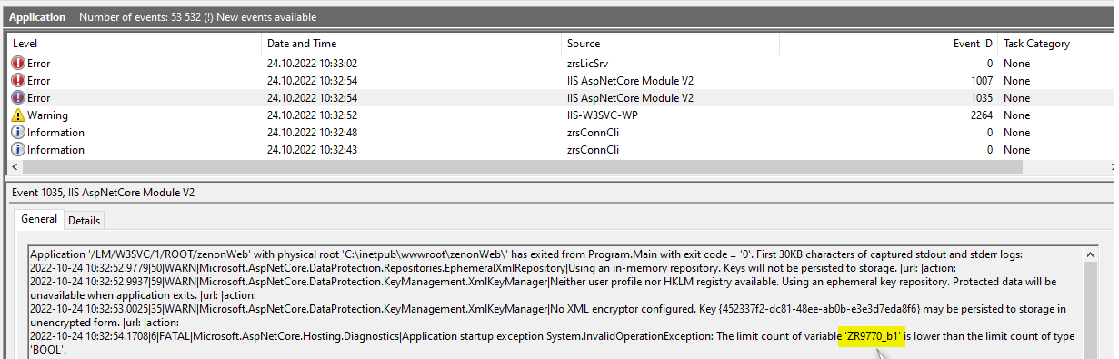

- In case HTTP Error 500.30: Variables data type properties have not been modified, e.g. Boolean variables have two limits defined in the project.
You can find more information in Windows Event Viewer (Event ID: 1032 || Source: IIS AspNetCore Module V2) pointing the name of the variable that can be causing troubles.
