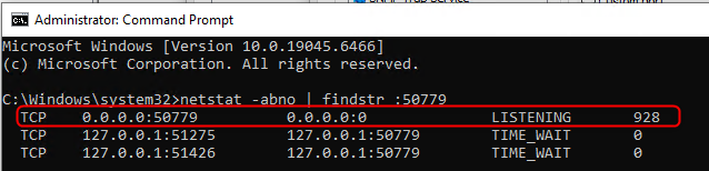

- Check if the zrsLicSrv service (Report Engine License Service) is running in Windows Services/Task Manager and the corresponding (default) listening TCP 50779 port is open and listening for incoming connections -> to do this, start the Command prompt with administrative rights and execute the following command: "netstat -abno | findstr :50779". Also make sure the corresponding PID in the output of the command (last column) matches the PID in the Task manager as this can exclude if other process is using the same port/socket.

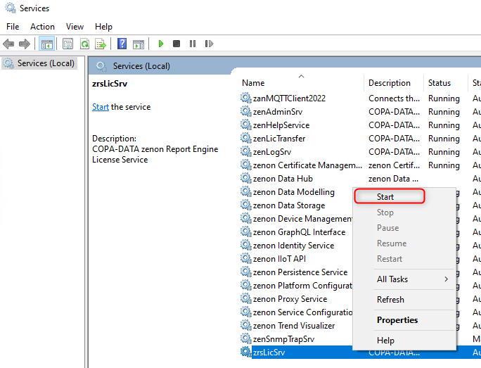

- If zrsLicSrv is not running, start the service via Windows Services and try again to connect to the Reporting metadata database.

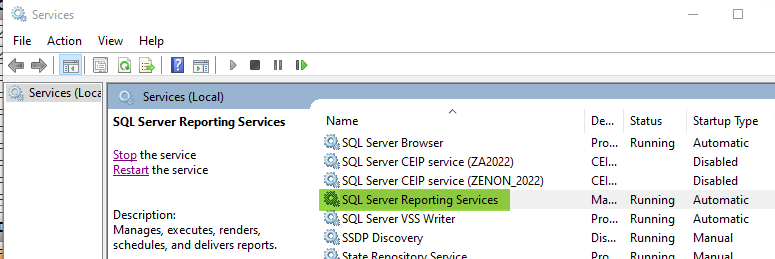

- Make sure the service "SQL Server Reporting Services" is running. Else, start the service and try to connect again in Reporting Studio.
