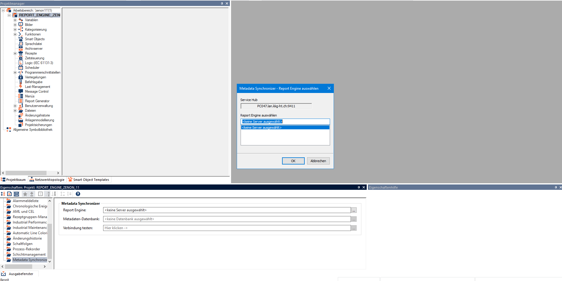

I have a problem with Zenon Report Engine. I'm making Zenon Report Engine training.
https://www.zenon-academy.com/content/course/231/lesson/436/content/2297
In chapter Reporting Studio & First steps - Metadata Synchronizer, I'm not able to choose Report Engine in Metadata Synchornizer. There is simply nothing that I can choose. Screen below. In training video 1:58.
Service Note Status has several errors:
 2024-03-20 12:48:21.251D-015-00001MQTTnet.Exceptions.MqttCommunicationException: Der Wert darf nicht NULL sein.
Parametername: host ---> System.ArgumentNullException: Der Wert darf nicht NULL sein.
Parametername: host
  bei System.Net.Sockets.Socket.BeginConnect(String host, Int32 port, AsyncCallback requestCallback, Object state)
  bei System.Threading.Tasks.TaskFactory`1.FromAsyncImpl[TArg1,TArg2](Func`5 beginMethod, Func`2 endFunction, Action`1 endAction, TArg1 arg1, TArg2 arg2, Object state, TaskCreationOptions creationOptions)
  bei MQTTnet.Implementations.MqttTcpChannel.<ConnectAsync>d__15.MoveNext()
--- Ende der Stapelüberwachung vom vorhergehenden Ort, an dem die Ausnahme ausgelöst wurde ---
  bei System.Runtime.ExceptionServices.ExceptionDispatchInfo.Throw()
  bei System.Runtime.CompilerServices.TaskAwaiter.HandleNonSuccessAndDebuggerNotification(Task task)
  bei MQTTnet.Internal.MqttTaskTimeout.<WaitAsync>d__0.MoveNext()
  bei MQTTnet.Adapter.MqttChannelAdapter.<ConnectAsync>d__32.MoveNext()
  --- Ende der internen Ausnahmestapelüberwachung ---
  bei MQTTnet.Adapter.MqttChannelAdapter.WrapException(Exception exception)
  bei MQTTnet.Client.MqttClient.<ConnectAsync>d__33.MoveNext()
 2024-03-20 12:48:21.251M-015-00001Disconnected. (from MqttClient)
 2024-03-20 12:48:21.251E-015-00001Error while connecting with server. (from MqttClient)
 2024-03-20 12:48:21.251M-015-00001Mqtt client disconnected. (from CopaData.Common.Mqtt.Client.Internal.MqttClientService)
This is how Service Node Interface od the Engineering Studio - Reporting looks like:
And Service Node Configuration Tool
BR, Jakub
