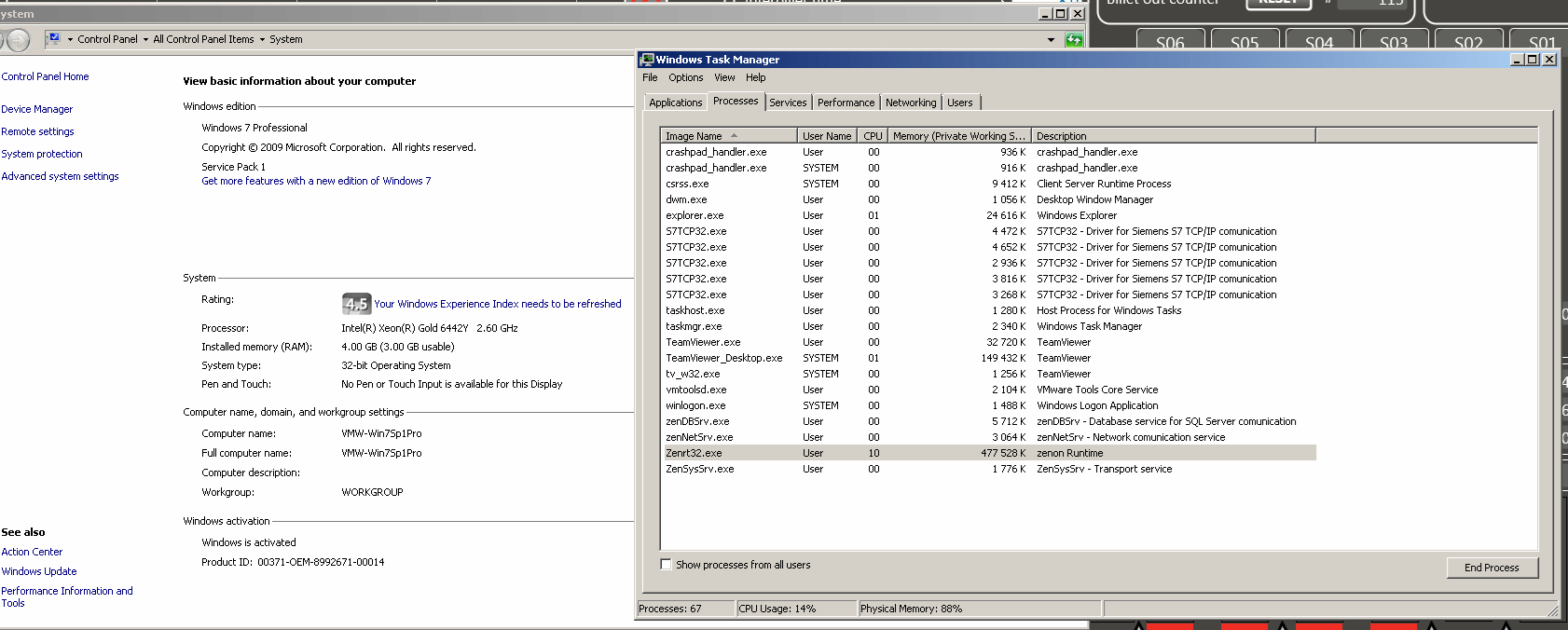

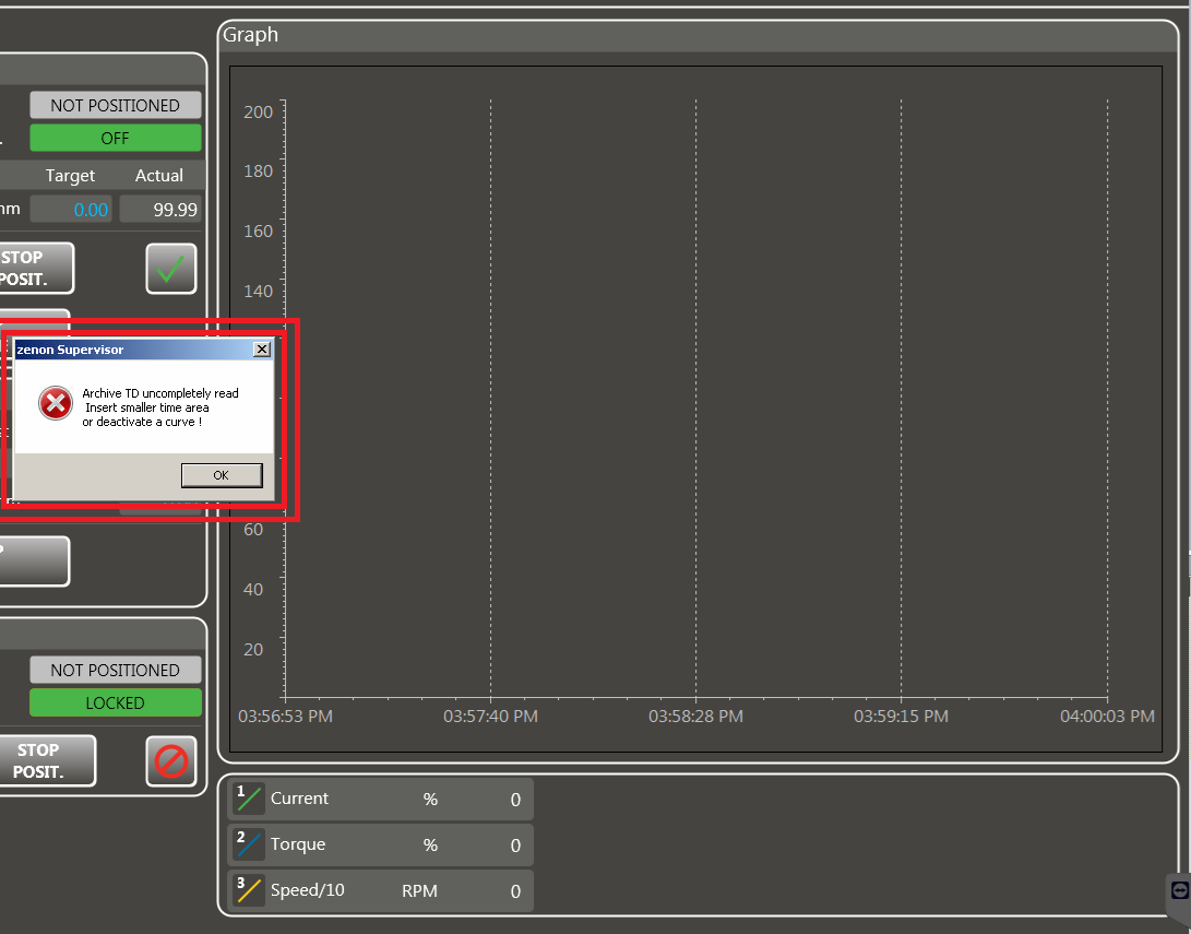

Hi,
I have old project in Zenon 7.00 SP0 build 13, and we use VM with Windows 7 Professional (32-Bit OS) for testing new pages we had to add in project, and since September it was working fine, but in last week and a half it started to show popup at screens with trends/graphs (screen type: extended trend; control element\Window\Diagram window). Message "Archive TD uncompletely read. Insert smaller time area or deactivate curve!". I have changed time from 3min to 1 min, and Historian is set to cycle read by deafult zenon settings. (i saw cycle is recommended for analog values, not to use on change), also it's recommended to have 4GB of RAM, but windows 7 can use max to 3GB.
memory usage
Graph object message
Does anyone have similar experince how to fix this?
