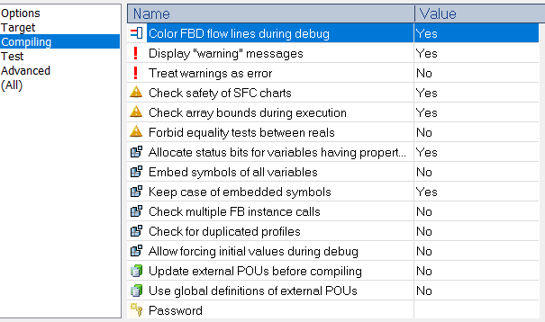

The configuration I have in Service engine settings (zenon Supervisor) and Project setting - compiling (zenon Logic)  is as follows:
  1. I have “State/Timestamp for Intern Driver variables” enabled - Yes.
  2. Allocate status bits for variables having properties - Yes
  3. Embed symbols of all variables - Yes
  4. Keep case of embedded symbols - Yes
Compiling

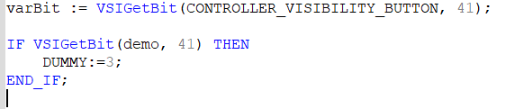

I have tried to set and get the values of bits M1-M8 (with VSIGetBit and VSISetBit) and I have succeeded, but when I try to get the values of WR_SUC and WR_ACK while changing the variable values in zenon runtime (service engine), I get no changes in these bits.
I also get the time and date with VSIGetDate and VSIGetTime.
I do all this in online (connection) in zenon logic and the part of the code and the part of the code that is not working correctly is as follows:
Code
As I understood it, with the configuration I have I could read all the status bits of the internal variable. Is there something missing in my configuration or in the code?
