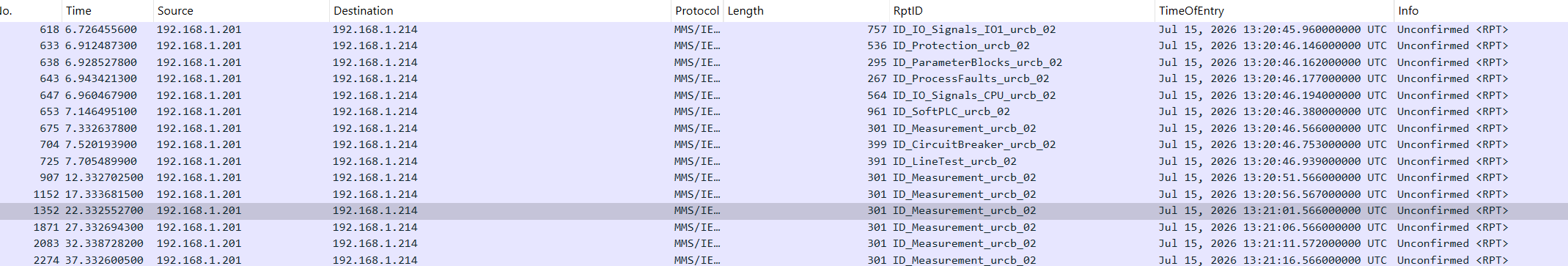

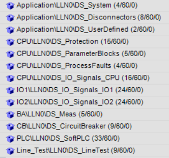

IED with 13 different datasets/URCB's

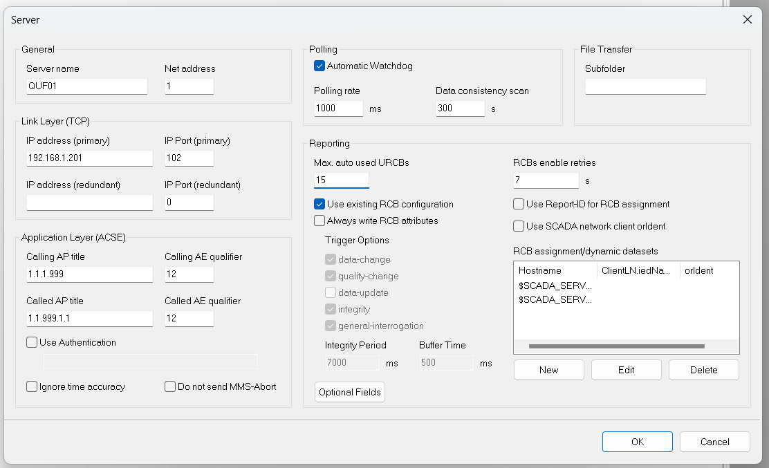

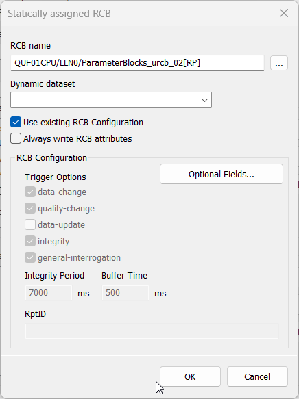

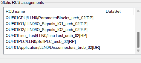

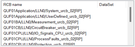

In Zenon I have the following settings:

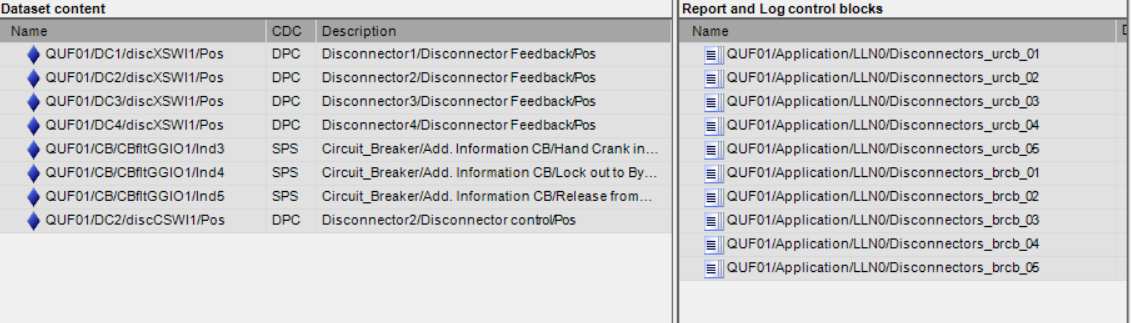

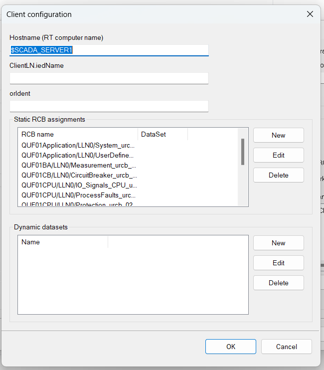

In here all the URCB have been added, 13 in total
When I however start the runtime it looks like Zenon is using only 10 of these defined URCB's

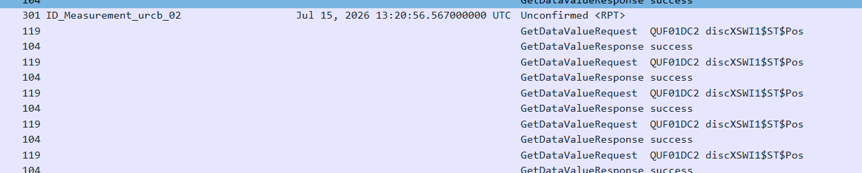

It also pulls for a value that is in one of the missing URCB's
