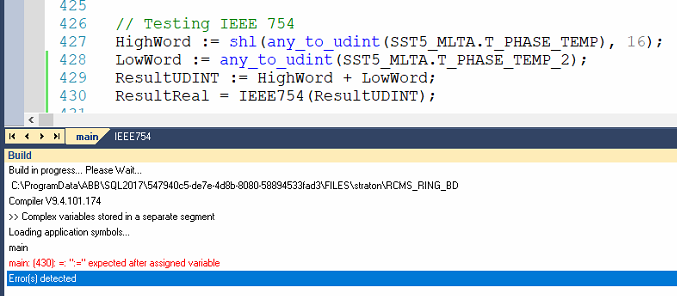

Dear all,
I am trying to convert 2 words to real (IEEE754 Floating point Value)
i already have the UDINT Value by using
var_udint := shl(any_to_udint(HighWord), 16) + any_to_udint(LowWord))
but using,
var_real := any_to_real(shl(any_to_udint(HighWord), 16) + any_to_udint(LowWord)))
this conversion is not converting to floating point IEEE754

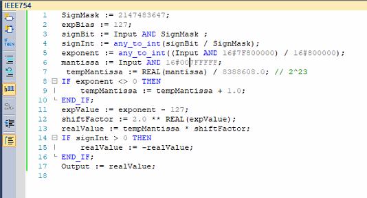

so i tried to create the manual calculation using UDFB, but currently i don't know how to call the UDFB.
There is this error when i am trying to build the project. Can somebody show me how to call the UDFB? and could this UDFB called many times in other variable?
Thanks for your attention.
