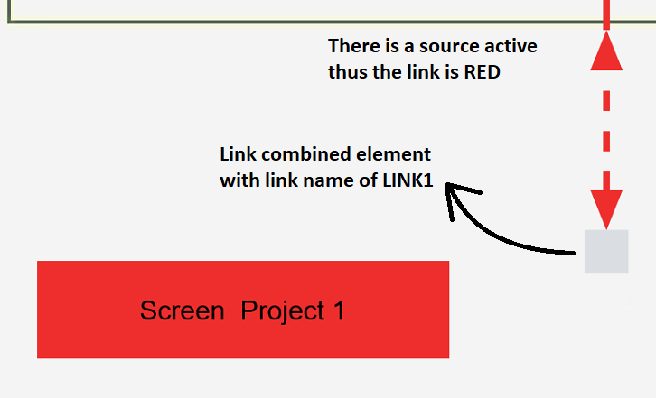

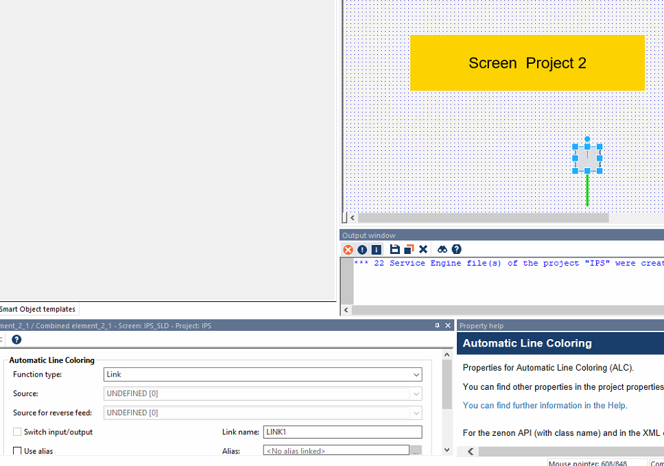

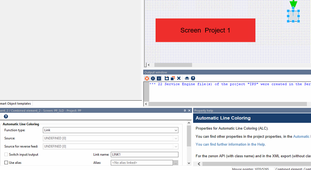

Currently I have applied the Integrated Project concept where multiple projects are contained in a main wrapper project. Everything is working as it should and I'm happy with the results so far. At each project here is an SLD screen that contain various sources and switches. I'm using the ALC method to indicate electrical flow from source to switch to load. I'm using two ALC functions, Source and Switch. I have read that the Link function allow me to carry the ALC continuity through out different portions of the screen and even throughout different screens within the same project. However, the Link ALC function only works if the screens are within the same project. I cannot use the Link function through multiple projects as far as I know (I tried it and it didn't work as indicated in the screenshots).
Is there another way to carry out the ALC continuity through different screens across multiple projects ?
The following photos will illustrate the problem I'm facing:
