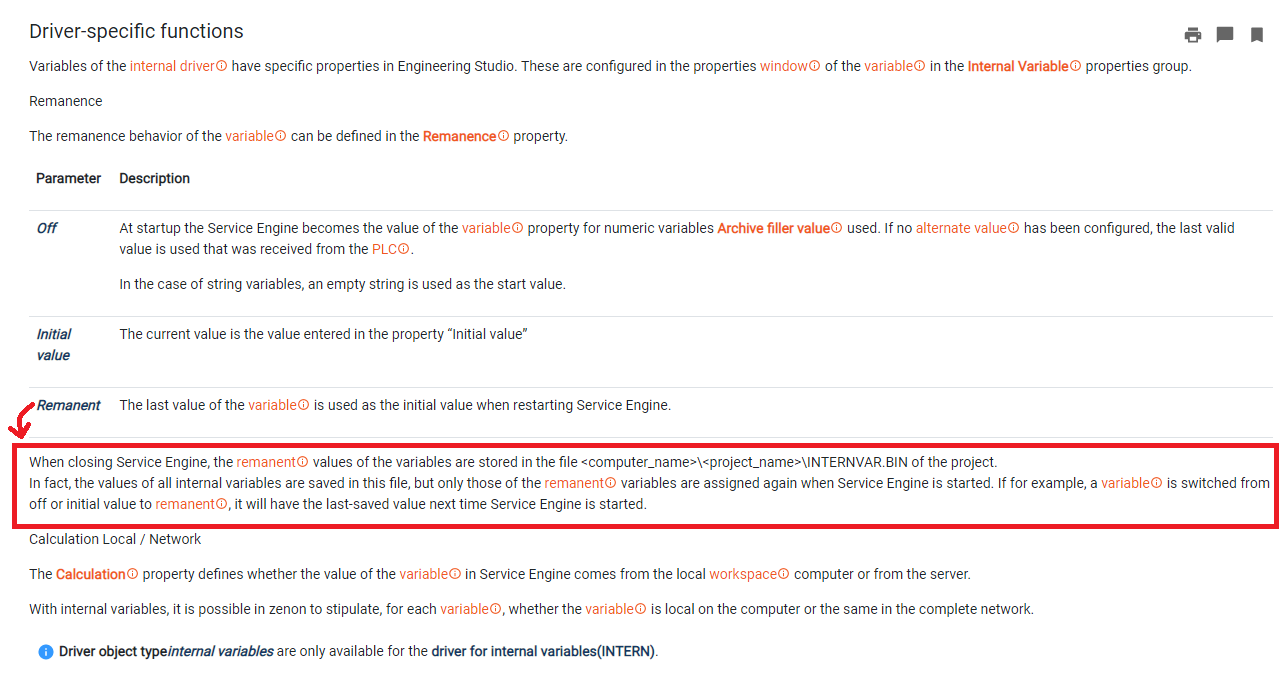

Now, when I backup the Project Workspace and restore it on another machine, all Remanent variables has been set back to empty. I have read that the Last Known Values of each Internal Variable is stored inside the INTERNVAR.BIN located at the project files and Runtime uses it to pull the LKV of the Variables upon shutdown/restart. My question is, why my values went back to empty when I restored the Workspace ? Does the INTERNVAR.BIN is included in the Project/Workspace backup ?
