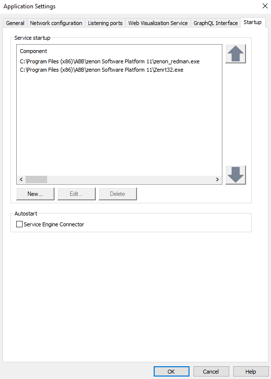

We configured the redundancy management tool as well as the service engine to automatically start as a service (the idea is that in a shut down case both services can start)
The service engine start ok but the redundancy management tool don't work properly as it show the service engine as stopped,

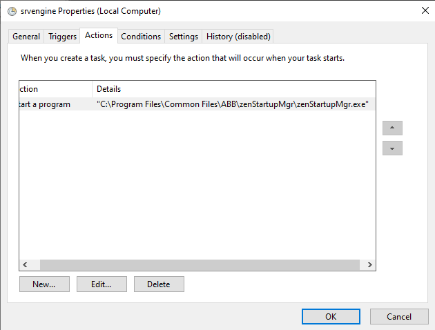

the startup tool is configured on the task scheduler to start with windows
The start of the service engine and the redundancy management is configured on the startup tool
Let us know if there is a solution for this issue,
