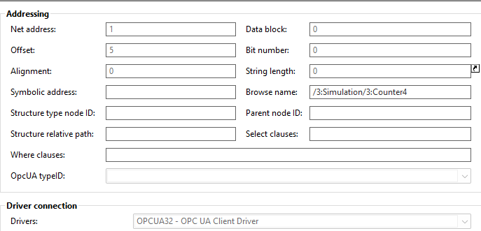

Hello,
Any way to increment OPC UA ''Browse name''? For ex. if I want to create SO in project with increasing names /3:Simulation/3:Counter1...Counter5.
I want to do this so I don't have to import from driver and then map the variables of SO with imported driver variables. I could create incremented SOs and be happy with that.
I also found that I can just export structured variable and then find/replace with notepad++ what i need and import them back but that makes SOs useless.
